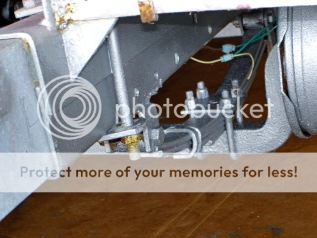

Trailer Updates
Well decide to work on the Herreshoff Harbor Pilot Trailer.... Add New Combination Trailer Light Kit ( Stop,Turn & Tail Lamp )..... The old lights worked fine ,but were NOT " Submersible " Trailer lights .... The old guy that I purchase my Herreshoff Harbor Pilot from - his son owns a small marina in atlantic city area , and the Pilot was lifted on & off the trailer with a fork lift and launched .... The son also custom built this trailer for the Herreshoff harbor pilot ..... I Lubed all the rollers before placing the pilot back on the trailer ..... I also plan to replace all four sets of Axle Bearing & Hub assembly units and a New trailer Coupler (quick-lock ) 2 '' ball size .... Tire's are in excellent condition.....
This trailer will be ready to travel with zero issues ..... I maybe taken the Pilot to Southwest Harbor Maine in Sept. ( 14 hour ride from South Jersey ).
« Last Edit: October 04, 2011, 04:54:26 AM by Cardinal Joe »

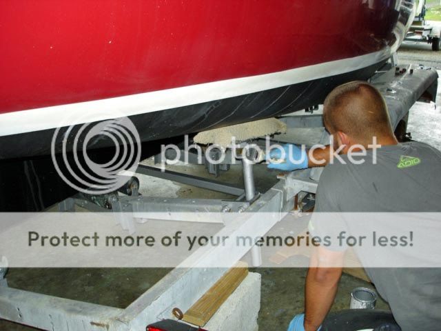

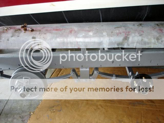

« Reply #214 on: June 12, 2010, 07:03:30 PM »
Old vs New
« Last Edit: October 16, 2011, 10:44:09 PM by Cardinal Joe »

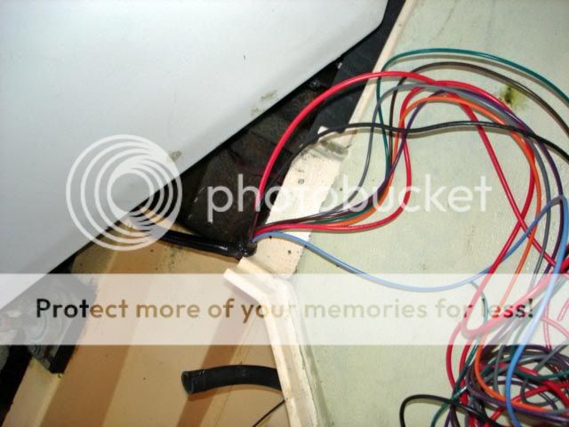

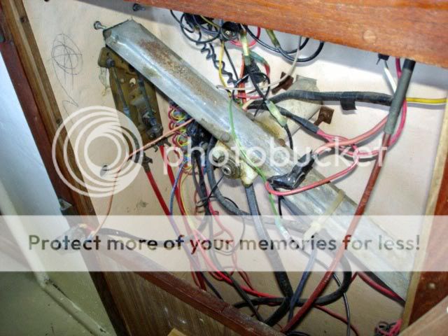

Rewired the Herreshoff Harbor Pilot.....
I decide to re-wire the Pilot including the engine wire harness & Bilge pump unit , after 36 years I think it was time , clean up a lot of old not needed wires... add a black tube casing for the wires, along the bulk head wall an out to the engine compartment ....
Old Wiring ( before )
New Wiring ( After )-with black tube wiring casing....
« Last Edit: May 09, 2015, 03:28:28 AM by Cardinal Joe »
« Reply #216 on: June 13, 2010, 10:15:40 PM »
Continue of New Wiring System...
New Bilge pump Wiring
« Last Edit: October 15, 2011, 07:30:42 PM by Cardinal Joe »
« Reply #217 on: June 15, 2010, 08:12:04 PM »
Picture of old circuit board panel...
New circuit board panel & new wiring....
« Last Edit: October 15, 2011, 07:46:41 PM by Cardinal Joe »
