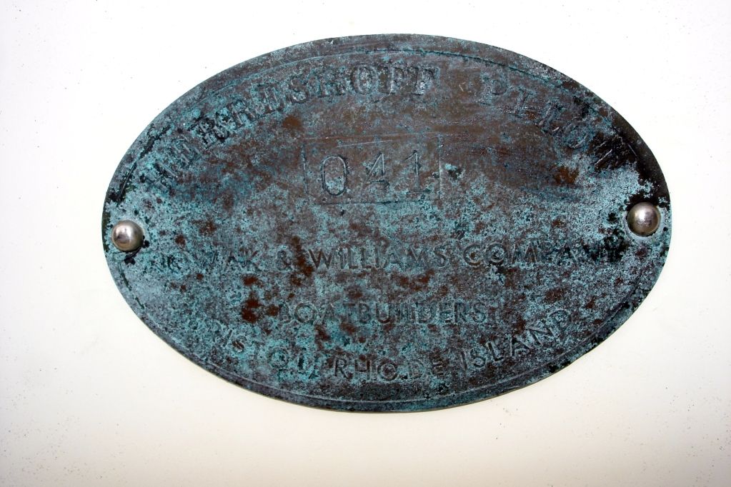

Herreshoff Harbor Pilot # 041 .......
Owner Tom Van Duyne

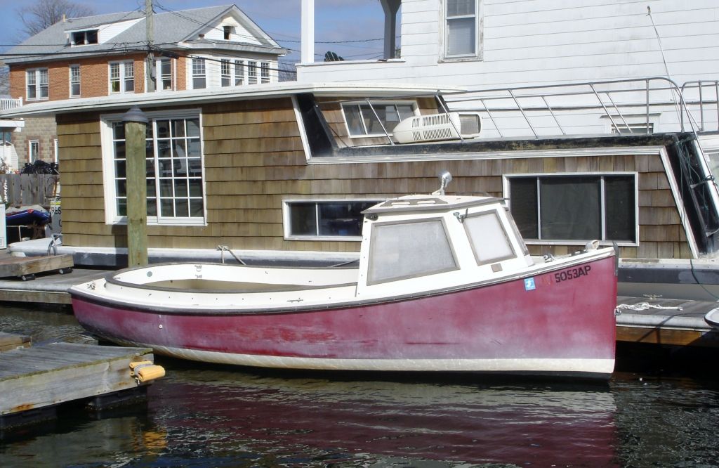

« Reply #830 on: November 21, 2012, 07:07:05 PM »
My Herreshoff 18' came from  M&W Boatworks in AC, NJ. She previously worked as a water taxi for Harrah's Casino, ferrying tourists between Gardiner's Basin, Trump Marina & Harrah's in the AC inlet, early 1980's.
Her previous owner was Charles Jury, a boatbuilder who lived on a houseboat in AC inlet.
The boat is named "My Buddy" in memory of my dad, John VanDuyne, builder, inventor, VanDuyne Lifeguard Boat, who passed away in April 1997. I saw the boat in Soundings Mag., she had all the qualities my dad taught me were important in a workboat, straight stem, round stern, deisel engine,big rudder.
It just made me think of him so much.
I have all original parts, the sail says water taxi. I took the mast off to go under the Dorset Ave. bridge at high tide.
She's a great flounder fishing boat! All good.

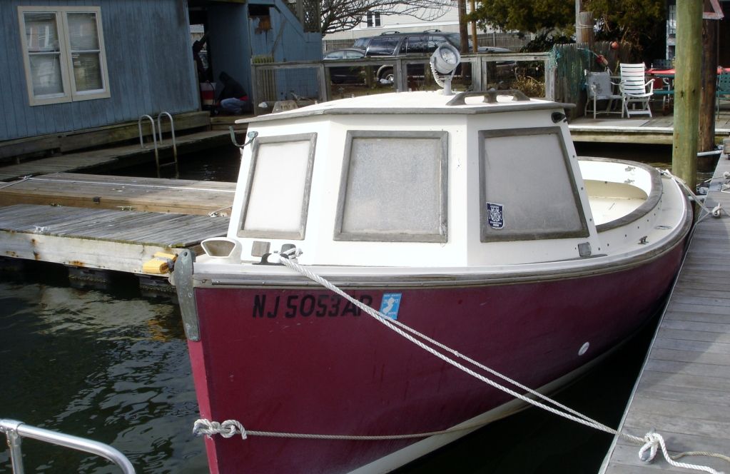

Tom > uses the Pilot as a Flounder Fishing Boat in the back bays , the previous owner was Charles Jury used her as a fishing boat for " Striped Bass " in the AC Inlet and inshore ..... Charles had installed Outriggers for trolling for Stripers & Bluefish...
 In the first foto below the Outrigger base bracket is still mounted on the port side of the cabin house side window ......

Original Bass Nav. Lights ......
Spot Light for Bouy seaching in AC Inlet ?
« Reply #836 on: November 28, 2012, 03:15:31 AM »
She is a weathered looking old girl .....
