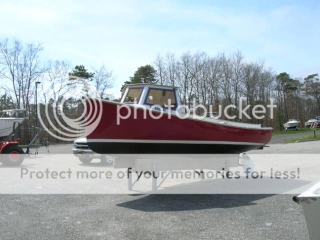

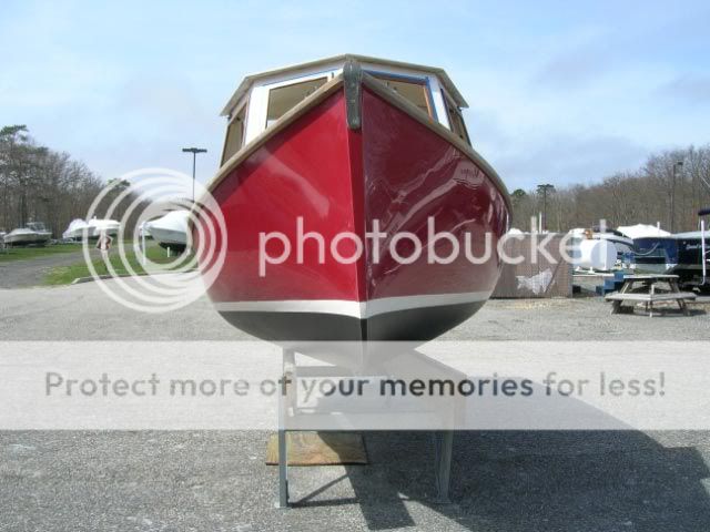

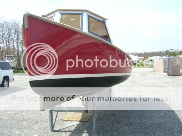

Patched some small air voids with a epoxy resin on the entrance  of the bow ,before barrier coating bottom .....
« Last Edit: October 21, 2011, 04:36:33 AM by Cardinal Joe »
« Reply #185 on: April 10, 2010, 03:37:31 AM »
Well , i when home for a few days and the boys - 1) Barrier coated 2) used a hard modified-epoxy antifouling paint that provides excellent season long protection 3) Micron Extra .... combines the slime blocking power of Biolux™ with controlled solubility copolymer antifouling paint technology to provide long-lasting, full-spectrum defense against fouling organisms. The antifouling ingredients are chemically bonded into Micron Extra’s copolymer matrix, which is engineered to gradually wear away as the boat moves through the water, much like a bar of soap.

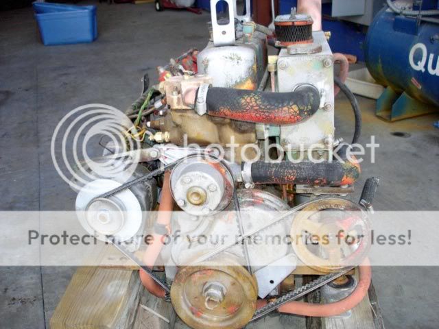

« Reply #187 on: April 12, 2010, 03:45:41 AM »
Someone had removed this engine to replace the Rear Main Seal on the transmission , and repainted the Westerbeke Diesel ( original color RED ) to Volvo Green including the motor mounts and re-install the engine/trans. back into the Herreshoff Harbor pilot ..... ? More Pic's ....
Before
After
« Last Edit: October 16, 2011, 09:43:17 PM by Cardinal Joe »

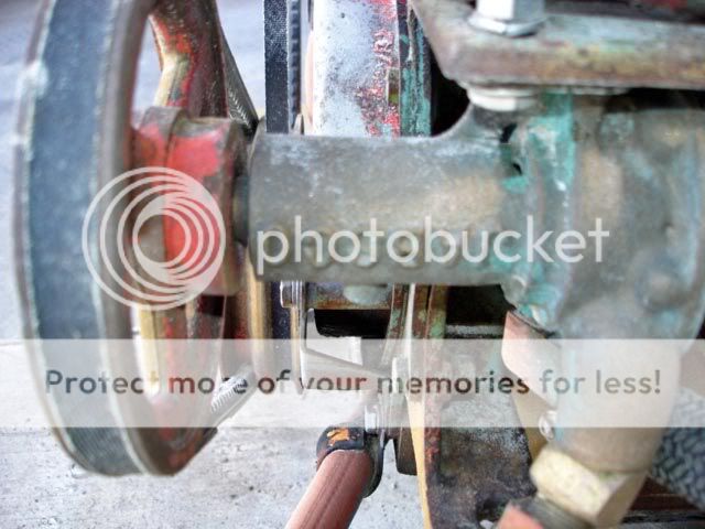

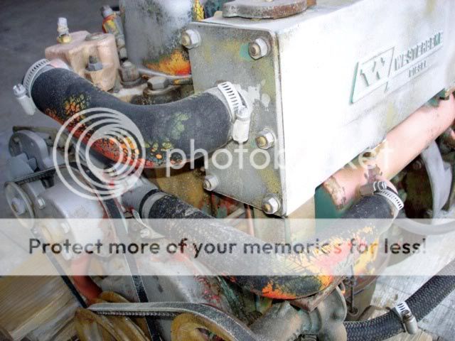

« Reply #188 on: April 12, 2010, 03:50:25 AM »
The picture below is the original hoses with the yellow primer paint ,followed by Westerbeke Red -they are 36 years old and have ( low hours ) only a few hundred hours on this diesel motor .....
Before
After
« Last Edit: October 16, 2011, 09:33:21 PM by Cardinal Joe »

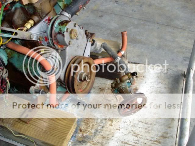

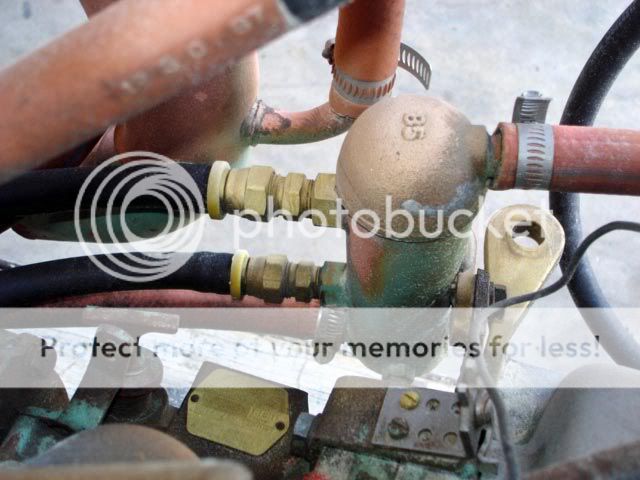

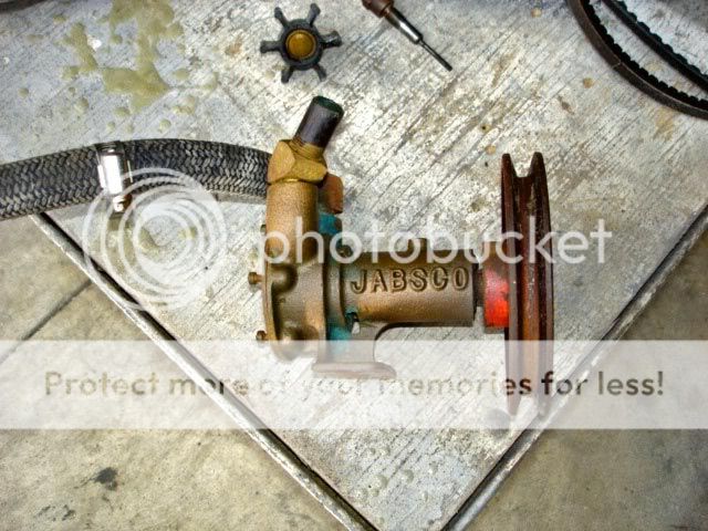

« Reply #189 on: April 13, 2010, 04:15:08 AM »

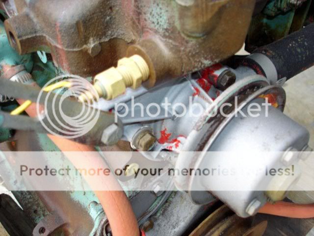

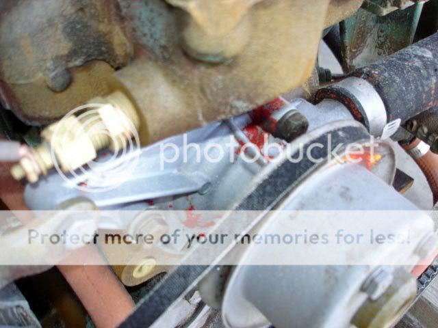

This engine water pump is Red ,so it had been replaced before along with a Impeller wheel ..
This Jabsco water pump had been replace because it was red in Color ...

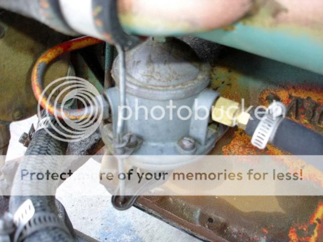

Original Fuel Pump
« Last Edit: October 16, 2011, 10:07:03 PM by Cardinal Joe »

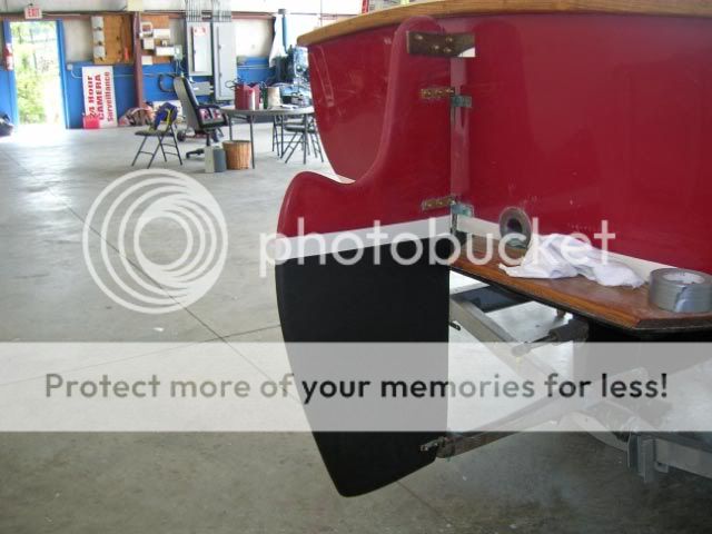

I got my Herrshoff Scout back from the painter and immediately took it to the trailer co. on their loaner trailer  3 weeks ago. It took them that long to get a trailer made for it. I go to pick it up last Sat. and they had scratched the hull in several places and now it has to go back to the painter again. Their expense but I can see an arguement brewing already between them and the painter. My luck.
Got a question for you.
The boat has a make shift tiller added to the top of the rudder head to get it over the transom an into the cockpit it works and its fine. But I would like to go back to as close as possible to original (wheel steering) equipt on this boat as I can. I found an old cable a red plastic cable with an inscription "MORSE E 304415-120IN 4427" one end is rusted off. I have the old wheel but nothing of the of the bulkhead mechanism to connect it to exists. Just an empty hole. The transom still has a small slot where some sort of short tiller must have been connected to the cable.
Any ideas on what I can do to find the parts to bring this back to close to original.
Thanks
Scott Silvia

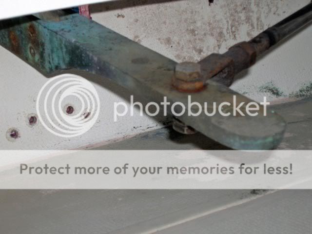

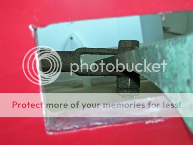

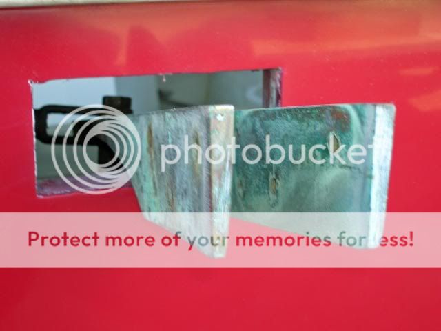

« Reply #191 on: April 16, 2010, 09:37:42 PM »
Steering on Herreshoff Harbor Pilot ......
« Last Edit: October 15, 2011, 07:03:59 PM by Cardinal Joe »
Scott
« Reply #192 on: April 18, 2010, 06:01:37 AM »
Thanks for the pictures Joe.
Guess I'm going to have to get one made out of stainless by a welder. I doubt I can find a bronze one
Scott
« Reply #193 on: April 20, 2010, 02:11:16 AM »
I doubt I can find a bronze one ? Scott
I think you are correct ! Cardinal Joe

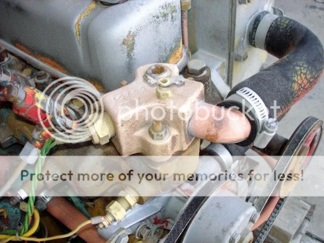

Westerbeke Diesel 30 W
More pic's of the motor being disassemable and either replaced with new parts or rebuilding the old parts .....
The Starter unit is orginial ( all copper wiring & steel casing )........ Alternator is about 20 years old - both of these units are going to be rebuild , because they are of superior quality , the new units today are Junk ......
Ordered 4 new Glow Plugs ,Water Pump Impeller & Hoses ......
