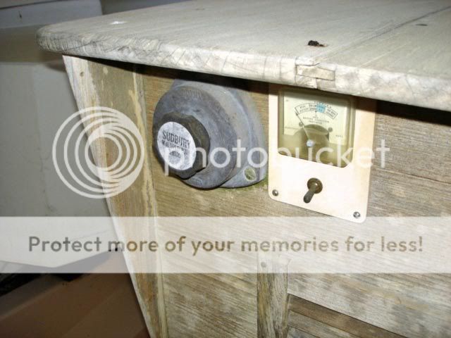

A previous posting from RIGGO ....... I have an HA 18 and currently has no electrical system on board. Any suggestions for battery location, switch panel?.......
Cardinal Joe's Pilot foto below......
Custom Teak seat/cabnet.....

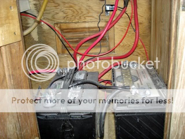

Inside of custom teak cabnet
Most Pilots have there Batteries stored in the bow hatch area.
I've also seen batteries placed in the stern of the Pilot under Cat Seating ....

Getting back to this foto , what you don't see is the 30 amp plug-in shorepower receptacle  to the right of the batterty switch/meter units ....
My Pilot has a " Inverter Unit " > 30 amp to 110 volt box receptacle.......
Follow the wiring from the above foto > you can see the Red battery swicth wires , then the one smaller black wire to the amp/volt gauge meter unit and to the left you can see the 30 amp yellow cable line going into the Inverter unit (not shown in foto) then if you look at the upper left hand corner of the above foto there is the corner of the 110 volt metal receptacle box.  Note.....  If a large storm is in the forecast (Hurricane) I may connect a 2 amp battery charger unit , because the Pilot is NOT a self baling boat and needs a bilge pump to remove the rain water...etc,etc.

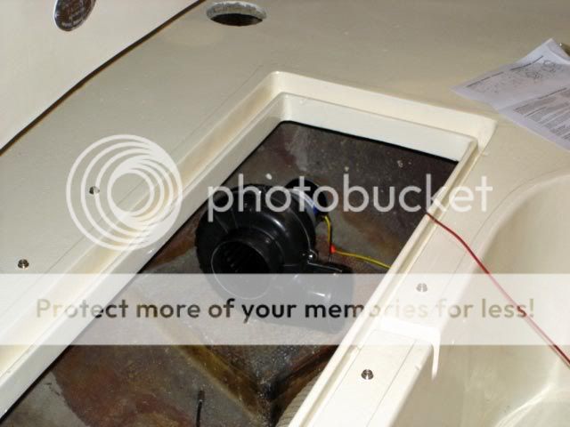

Wondering whats under that piece of plywood in the stern of the hull (under the blower motor in foto below );
Lead Bars....
Question ? - WHY the extra weigh to the port side of the Pilot's ?  Yes the Starboard side has an 18 gal. fuel tank = about a 126 lbs/diesel or about 108 lbs /unlead gas .....?    The engine & batteries are usually centered in the middle of the hull ......  so, why the off set of weigh to the port side ???    Any thoughts on this subject ??????  Anyone !

I was wondering the same thing.  My Pilot has two big bags of cement in the same location.

Wrong Adam, but I'd guess to offset helm location?
« Reply #486 on: November 28, 2011, 10:16:45 PM »
Sounds about right ...... or it would look like the foto below ; with the weigh of the fuel tank on the Starboard side .....
