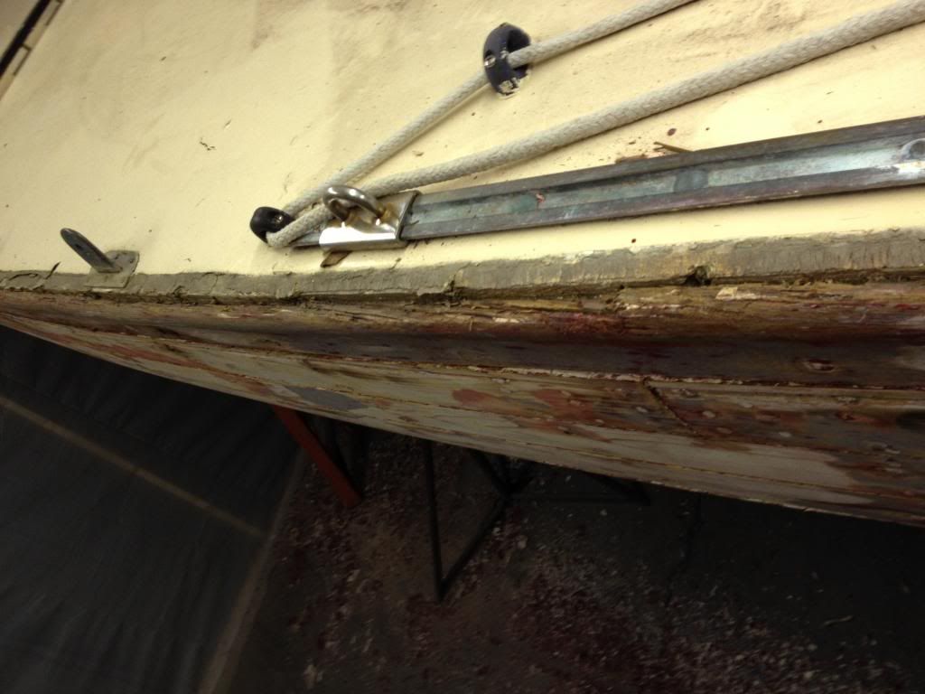

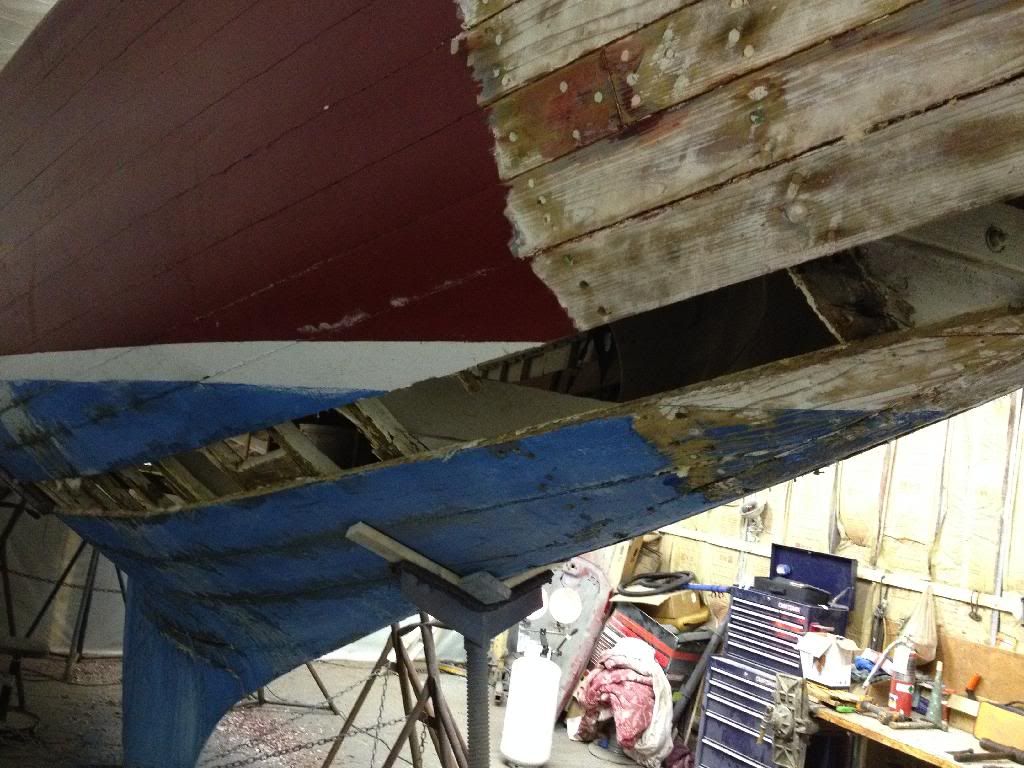

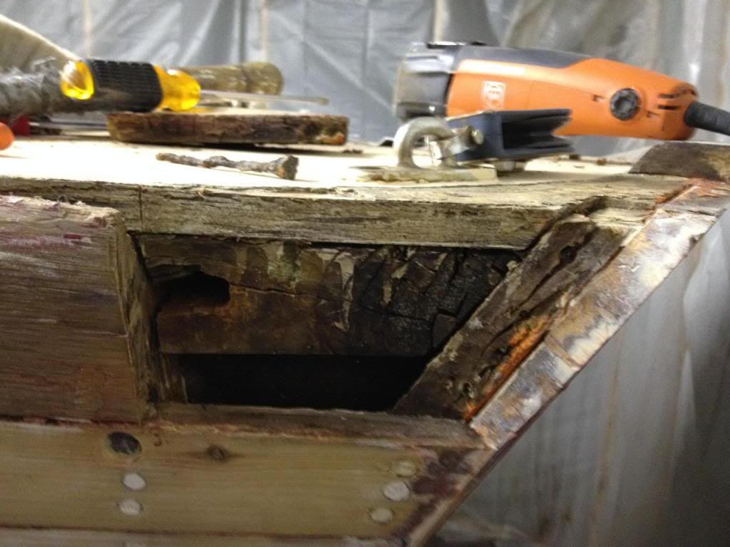

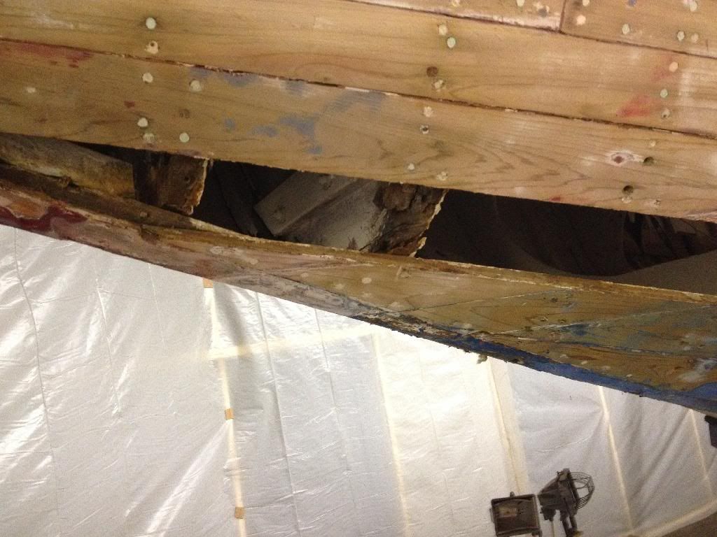

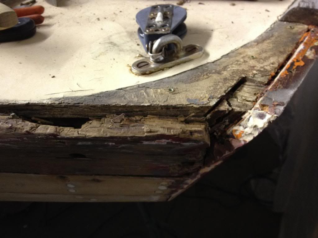

I got into the port side sheer strake today and it is in worse condition than I expected. I removed the toe rail and uncovered plenty of rot. The worst of it is in the rear quarter as you can see in the following photos. I cut out the rotted end to the closest frame and exposed the internal structural components. Fortunately the clamp and frame are not rotted. You can see the remains of the iron bolt I removed sitting on the deck the large hole to the left is a good example of the result of iron sickness.  :o
 My idea is to sister a cleat onto the frame to serve as one of the attachment points for the replacement piece. I will then dovetail the existing end of the sheer strake and fashion a new piece to fit.

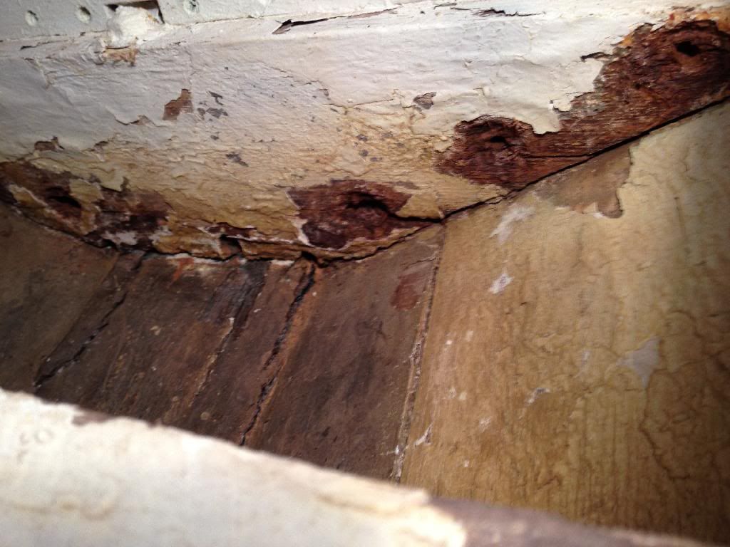

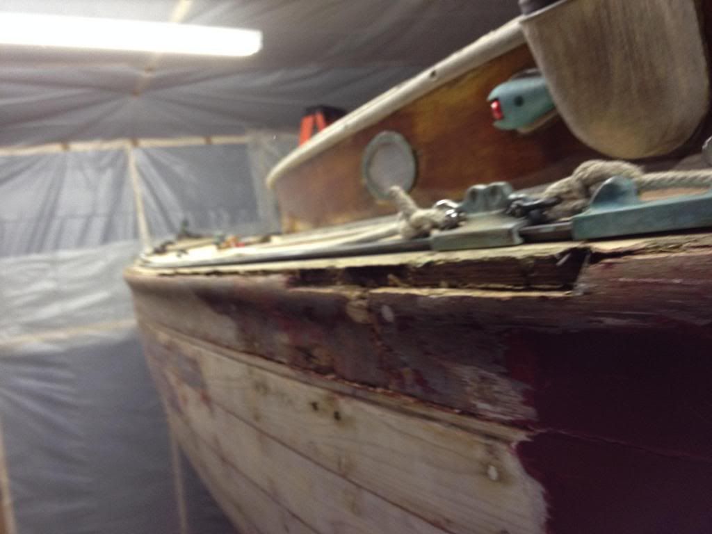

The following pictures show the rot that was under the toe rail. My plan is to rout down about 5/8" along the entire top of the sheer strake and glue and screw in a new piece of white oak and reshape it. I expect that the starboard side will need similar treatment.

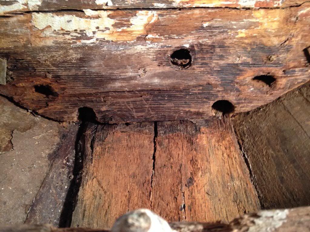

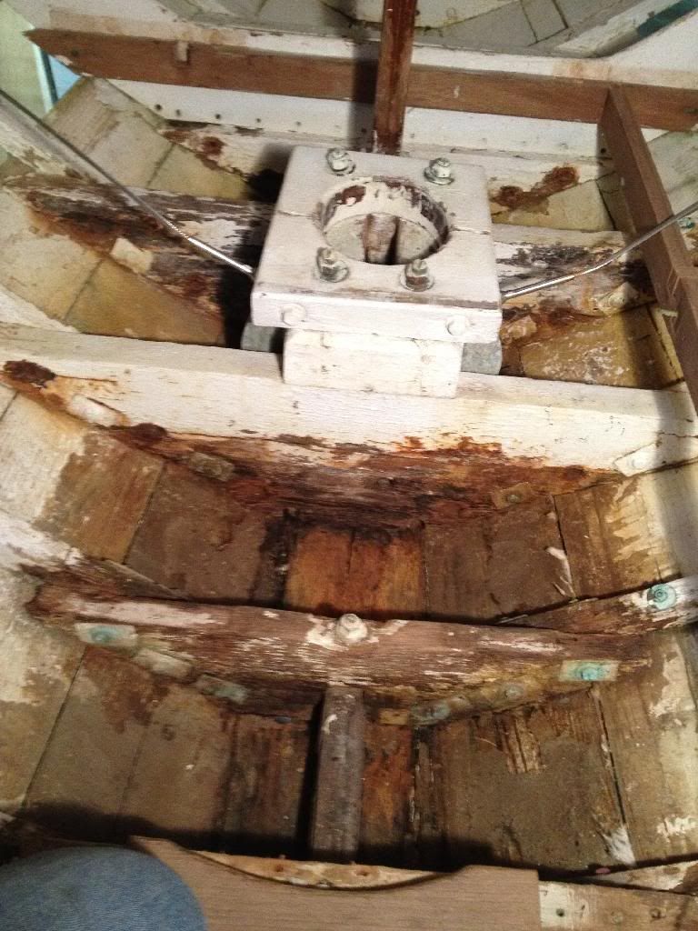

I am in the process of removing as much of the iron fasteners as possible. Today I removed the iron bolts from 4 of the floor timbers around the mast step. At some point in the past new bronze bolts were fastened through some of the floor timbers into the frames. Unfortunately, the iron bolts were not removed at that time. You can see the iron sickness that occurred. The holes are now quite a bit larger than the original holes. I am not sure what the best course of action should be here. I am thinking I need to fill the old holes with an epoxy filler like West System and drill new holes then install new fasteners? I fear that using the old holes would allow the timbers and frames to work free.

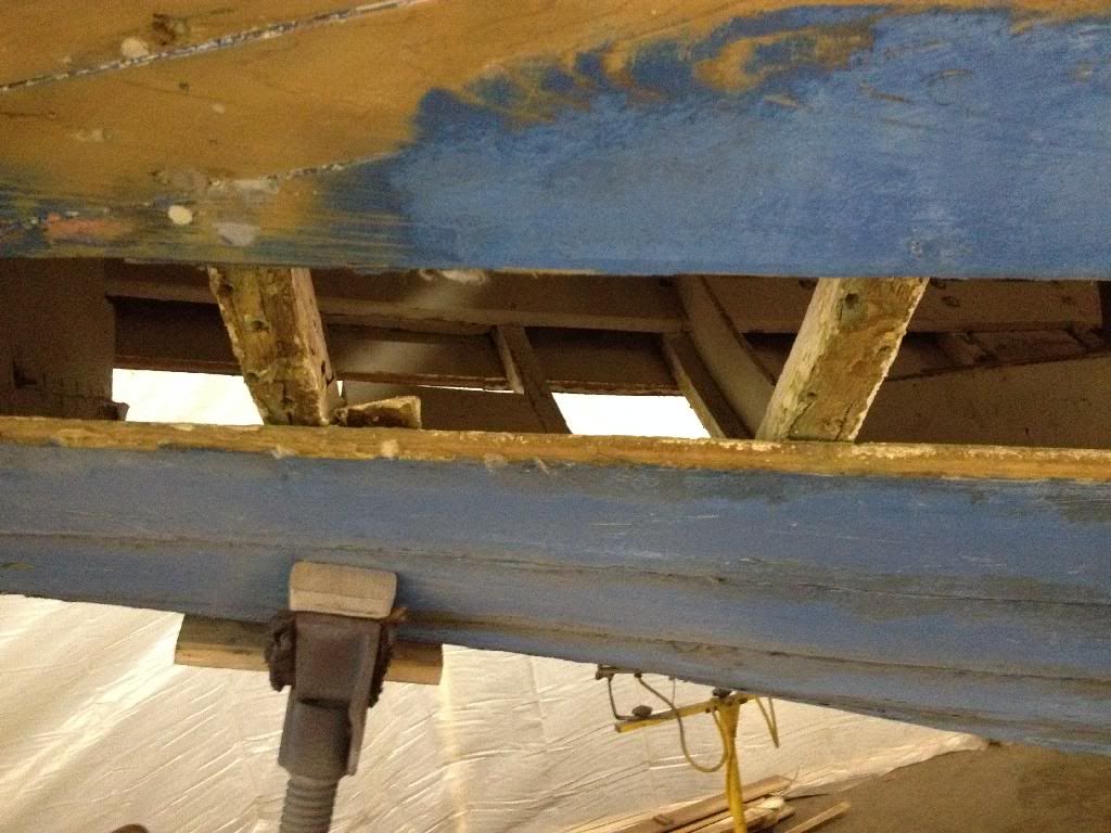

I decided to remove a plank on either side to better access the frames and timbers that I need to work on:

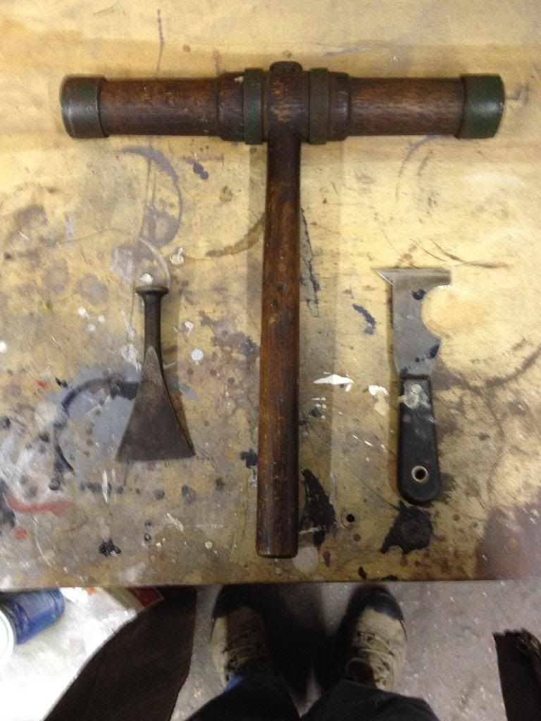

You can find anything on eBay. Here are my new/old boat wright tools. Pretty sweet!
