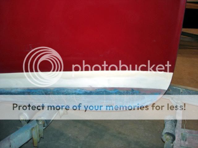

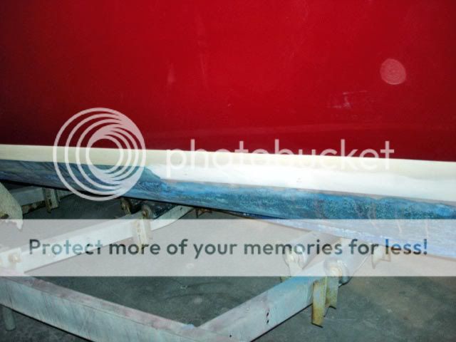

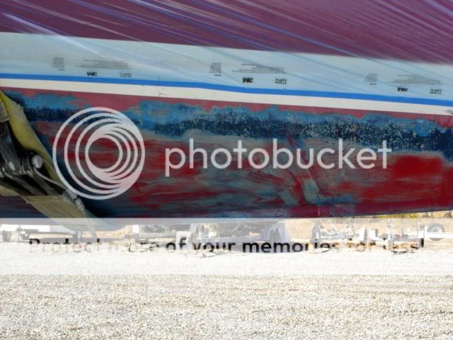

Started sanding the water line , to come down a few inches , before using the Farrow Blasting System , because of the New Red GelCoat paint job and found that the White boot stripe is really White GelCoat and is 2X the wide as shown in the photo's below ....

« Reply #137 on: March 02, 2010, 02:17:06 AM »
White GelCoat Water Line ....

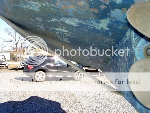

« Reply #138 on: March 04, 2010, 05:36:09 AM »
Well Pic's say it all.....
« Last Edit: October 15, 2011, 09:27:38 PM by Cardinal Joe »

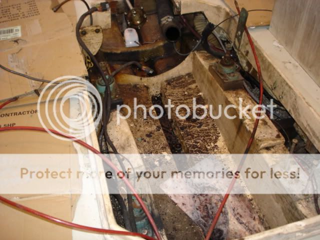

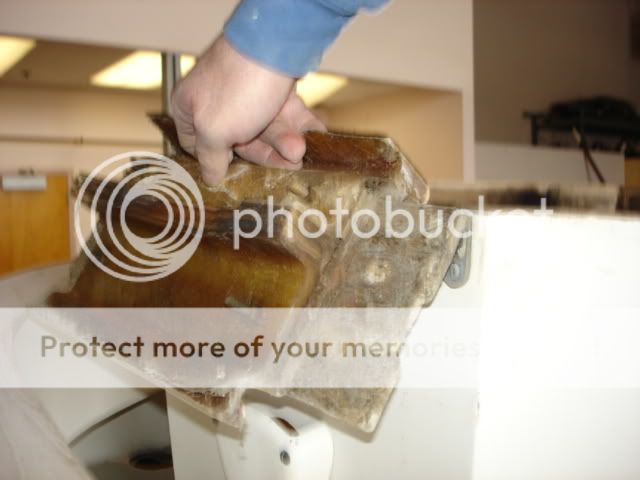

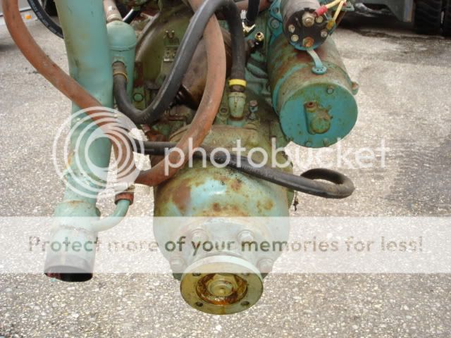

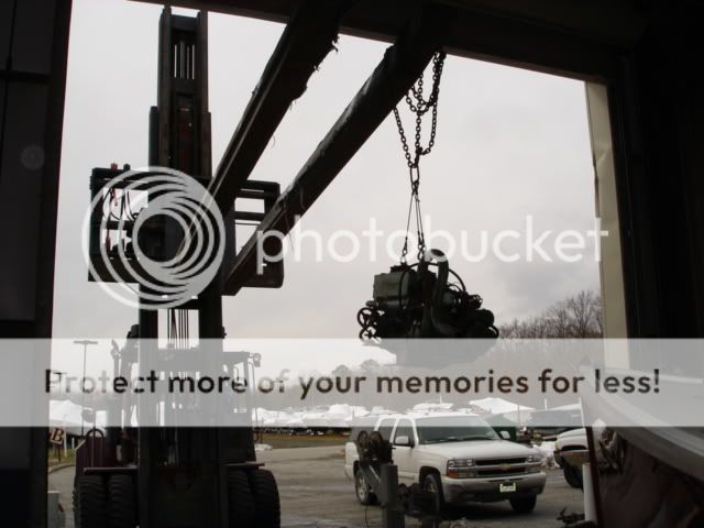

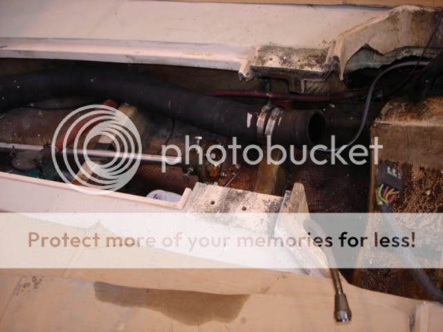

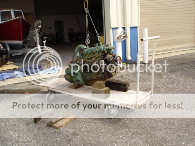

« Reply #141 on: March 04, 2010, 05:52:36 AM »
Infor. on the above Photo's
If you notice the deck floor had been cut out around the rear of the Transmission ….. The Rear Main Seal had been replaced on the transmission also I notice that any replacement parts on the motor were red in color or unpainted …. Well it appears that the fresh water, oil & fuel pumps along with the alternator, starter solenoid , one pulley , fuel filter canister plus lines, and belts had all been replaced at one time or another …...
Also it appears that I had a very small fuel leak from one of the fuel lines ...... from the photo's above it also shows transmission fluid in the bilge , but it was left over from the leaky rear main seal – the new seal looks very resend ,maybe less than a year old ?

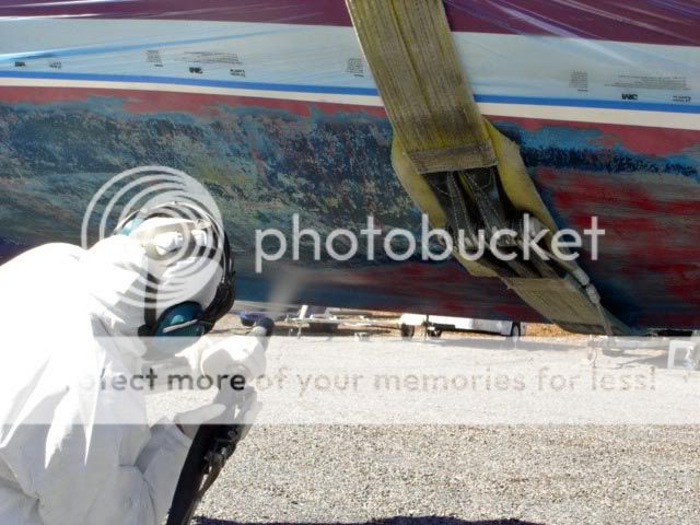

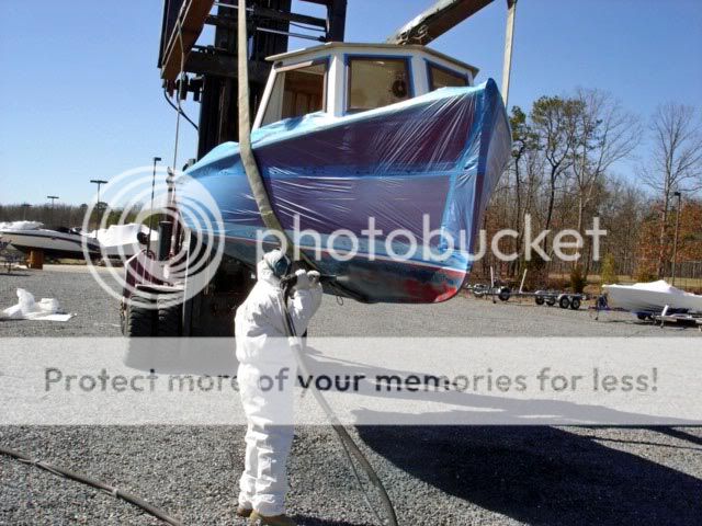

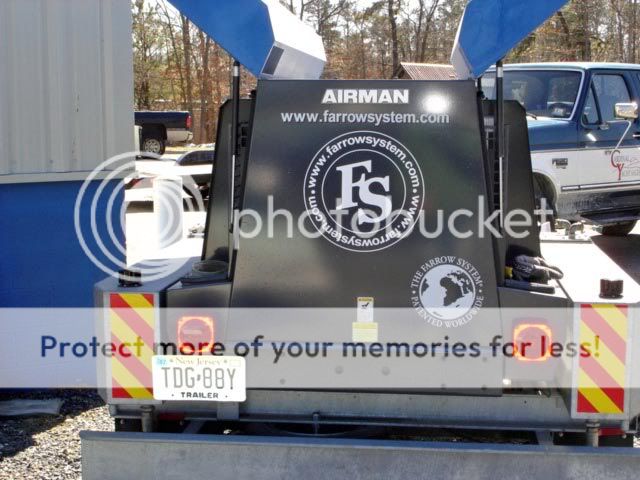

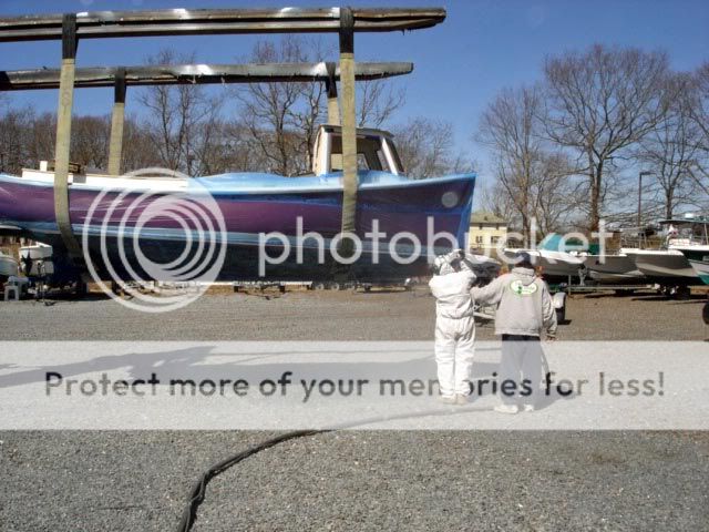

Prep - for " FARROW BLASTING SYSTEM "

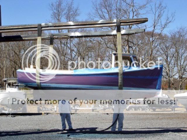

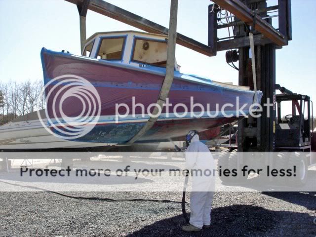

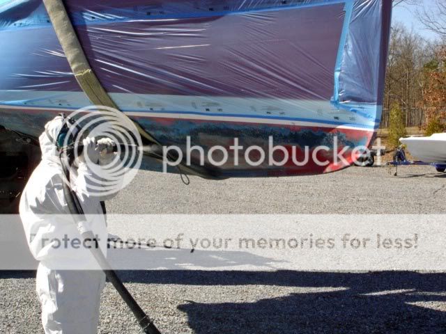

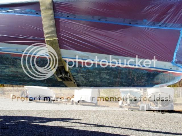

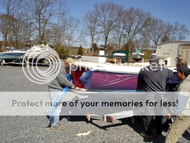

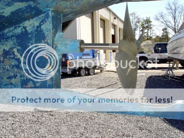

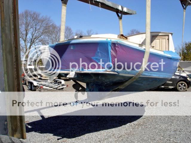

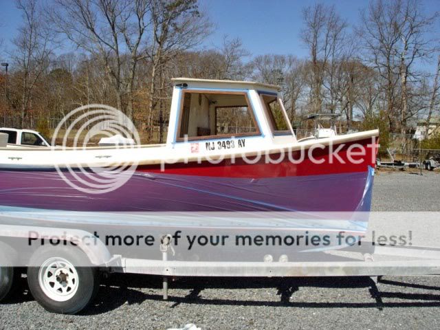

First Nice day this year took the PILOT outside and used the Farrow System on the Hull ....
« Last Edit: October 15, 2011, 09:40:40 PM by Cardinal Joe »
« Reply #146 on: March 07, 2010, 04:38:04 AM »

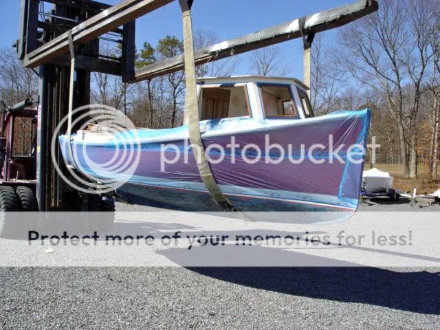

More Pic's of Pilot ....
« Last Edit: October 15, 2011, 09:43:00 PM by Cardinal Joe »
« Reply #147 on: March 07, 2010, 04:42:41 AM »

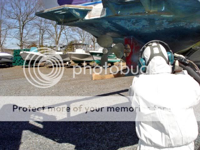

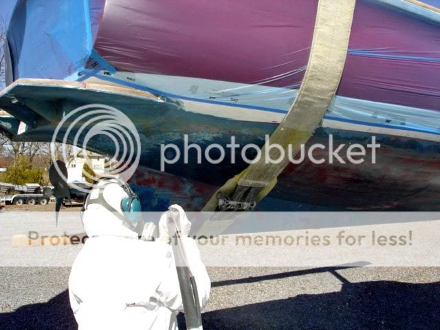

Using the Farrow Blasting System ....Still More Pic's of the Pilot.....
« Last Edit: October 15, 2011, 09:45:29 PM by Cardinal Joe »
« Reply #148 on: March 07, 2010, 04:47:02 AM »
Farrow System in use on Herreshoff Harbor Pilot ....
« Last Edit: October 15, 2011, 09:48:25 PM by Cardinal Joe »
