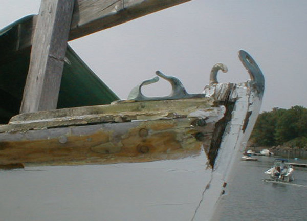

I have seen many 12 1/2s of various vintage, but i have yet to see an oar lock socket arrangement where the oar lock is on a separate mahogany block adjacent to the coaming like th eone on my boat.  I am thinking that this is not original.  Anyone seen one like this?
Also, I took the bow hardware off tonight and the bow chocks are apparently joined through the stem by a pin.  In my case the pin was steel.  I thought this was odd since it was completely corroded.  Shouldn't this be a bronze pin?

I have not seen an oar lock socket arrangement like this before.  It could have been done by a prior owner?
What is the 'flying buttress' for?  Maybe a motor mount bracket?  Is there a similar arrangement on the port side?
Your boat would have been fitted with the later-style bow chocks.  Do they look something like this?
After mid-1936, HMCo switched to this style and subbed them out to a contactor rather then cast them in-house.  I would have to crawl through my notes from an MIT visit, but as I recall the casting cards specified bronze.  Many boats from this era had steel hardware, which causes me to speculate that, though bronze may have been written in the casting cards, the actual contract may have not been specific.
Is it that your chocks are bronze but the pin is steel?  I would probably replace it with a bronze pin.
I can post more pictures later, but it is apparent that one of the previous owners added the buttress pieces (two starboard and two port), and an extra side brace at the aft end of the coaming, and probably this oar lock block in an effort to strengthen the coaming.
No, I apparently have the original style bow chocks
Is it that your chocks are bronze but the pin is steel? YES I would probably replace it with a bronze pin. Yeah, that is the way i am probably going to go.
I also don't understand why the drifts in the transom are steel.  I am planning to use bronze for those as well.

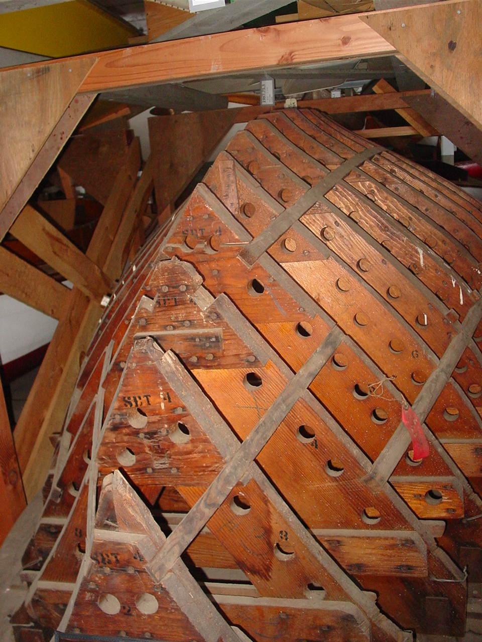

While doing this, I thought of an interesting dilemma.  According to the book "How to build the Haven", it was the Herreshoff method to bevel the molds so the frames do not have to be beveled. However at stations 6, 7, or 8, or 20 ,21, and 22 where the bevel is significant, the frame will be at an angle to the floor timber where it is to be attached, and therefore not flush.  If you attempt to fasten the frame to the floor timber without inserting a small wedge shaped piece you will either have a loose mechanical joint, or you will force the frame away from its intended angle. Either way not good.  I am thinking of inserting some kind of a wedge unless anyone has any other ideas???

The boatbuilder/instructor I was working with to restore a BB15 observed that boatbuilding is all about problem-solving.
Here is a photo of one of the 3 sets of original HMCo molds, on a strongback in Aladdin's Cave at Mystic Seaport.  Besides for the bow, where it gets a little tight, it doesn't look like the molds have much of a bevel.
Forum member Bob Perkins is also working on restoring a 12 ... mybe he will chime in.
