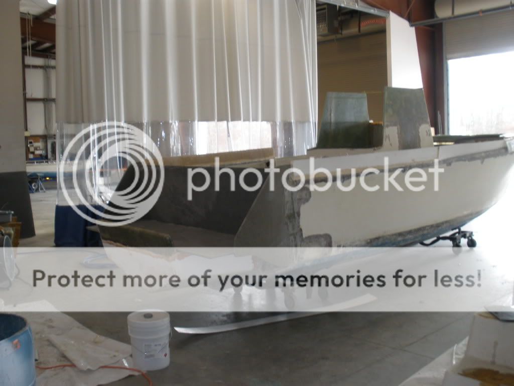

Formula 233 converted to 27 foot outboard euro transom .......
And you thought you had your hands full this winter! Look below and think again! Everyone who has seen this boat just shakes their head as they walk by. My dad has been working on this boat all winter and its finally starting to look good. Nobody in their right mind would ever think of taking a project like this on. My dad with his creative mind decided that since he retired he would build a boat to suit his needs. We took a proven bottom the one that started it all such as regulator contender seavee rampone just to name a few. We never really knew what the bow was going to look like til it just started coming together. Enjoy I will try to keep the pics coming. The whole boat was gutted down to the hull. New coosaboard stringers installed. Everything is made out of coosaboard, vinylester resin and 1708 and 1808 glass. All quality materials to build a boat to last a lifetime. Oh and I forgot to mention we have two 250hp yamaha OX66 outboards to install we're taking a poll on what she'll do. I'm guessing 70, 71 mph when propped right and trimmed but mid 60's easy.

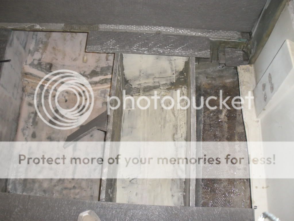

Re: Customizing a Formula 23 Hull
« Reply #2 on: March 21, 2010, 08:15:31 PM »

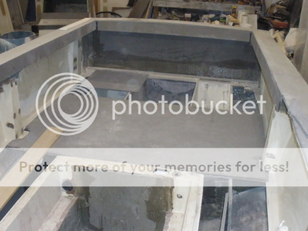

« Reply #3 on: March 21, 2010, 08:21:55 PM »

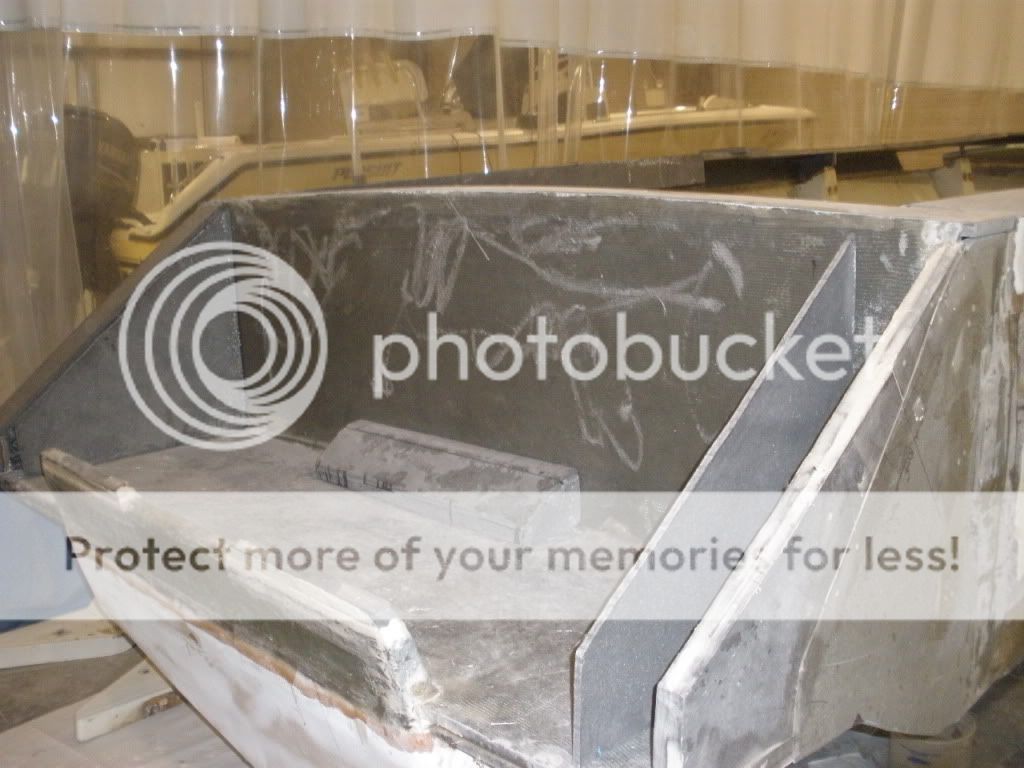

« Reply #4 on: March 21, 2010, 10:33:03 PM »
This is a Picture of the Engine / Outdrive ( IO ) on a wooden pallet next to Flower Pot - BW 13 .... that was removed from EL Ray ......
« Reply #5 on: March 22, 2010, 03:06:02 PM »
What is the ouitdrive? DP290?
« Reply #6 on: March 23, 2010, 04:46:25 PM »
DP 290 - I think is a Volvo unit - It had a Mercruiser unit .............
