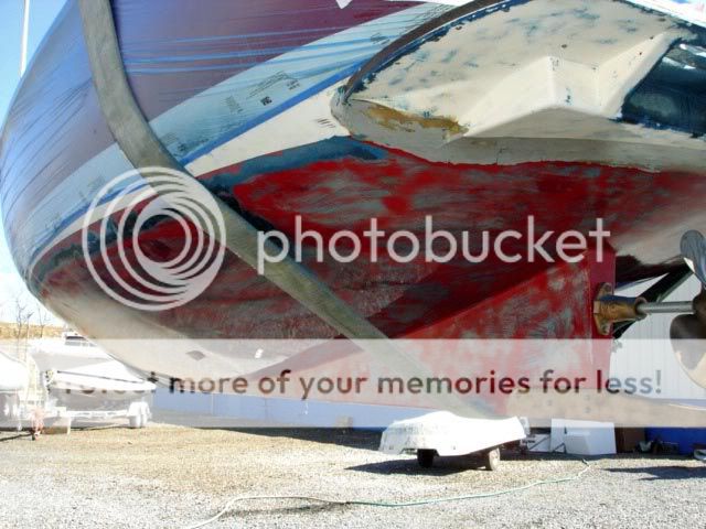

keel foto - Lola

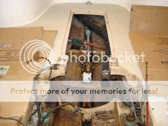

A discovery has been made in the Herreshoff Harbor Pilot Hull ,  Dave from the "Pug Tug" has discovered a drain hole in the hull..... Yes, I should've known about this and I believe at one time I did...... when I remove the engine from the pilot.......,the reason that I didn't remember this drain plug, when talking to Dave before " Sandy "... is I was picturing the bottom of the hull. after I had soda blasted,,,,, there was no hole on the bottom of the hull ,it wasn't protected by a bronze clam shell .   Dave made the discovery when he was reaching down to clear some leaves out as he winterize the boat......  he discovered a long Bronze T handle drain plug....  using vice grips it came undone ..... he heard the water coming out , and immediately jumped off the boat, to see where the water was draining out of the hull....  it was coming out of a small  hole in the bottom of the keel itself..... that's why I didn't see a brass drain fitting ....  I do have a picture with the engine removed and looking into the engine compartment I can see the drain plug handle in the second cross stringer ,the drain plug is directly in the middle of the boat, behind the transmission !

« Reply #862 on: December 10, 2012, 02:03:41 AM »
Hull Drain Plug is in front of the stringer before coupling shaft to the transmission  ( not seen in this foto )
Seen in this foto , in front of stringer ......

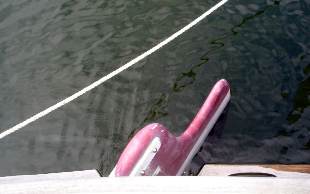

« Reply #863 on: December 10, 2012, 11:01:23 PM »
cont... " My Buddy" > Cat Rudder

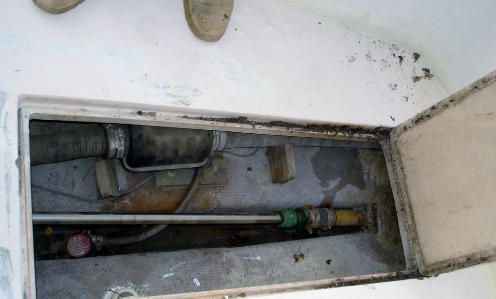

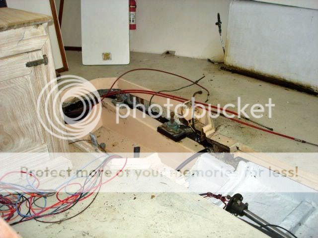

« Reply #869 on: December 14, 2012, 05:11:54 AM »
Cont.... Under deck of " My Buddy " .
