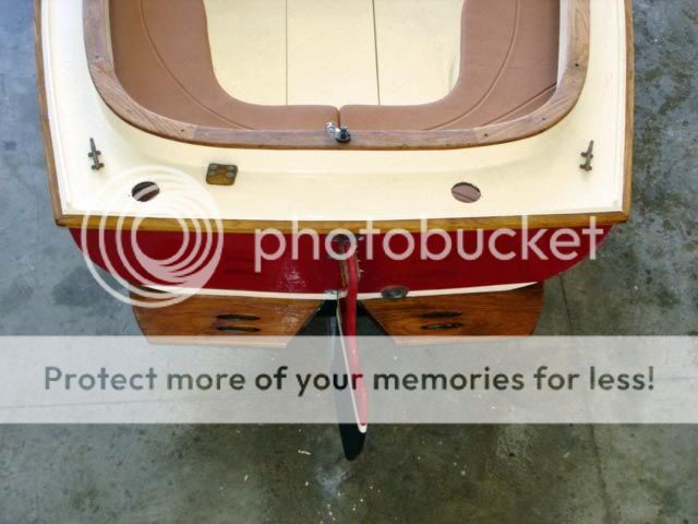

« Reply #272 on: October 03, 2010, 03:37:21 AM »

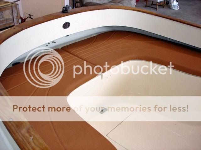

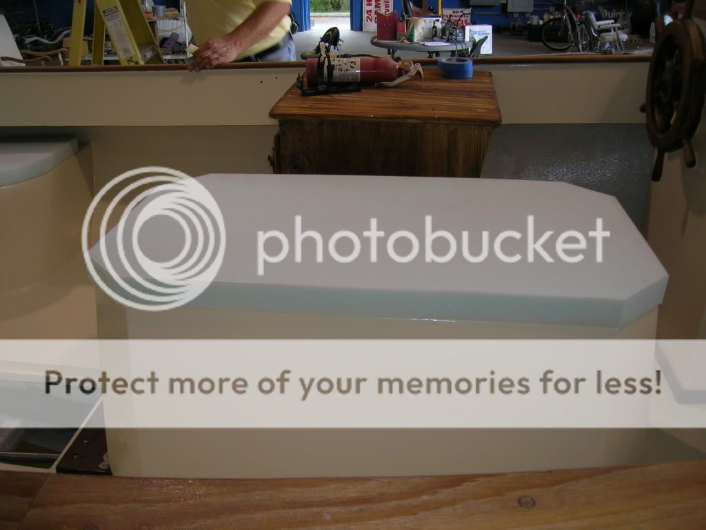

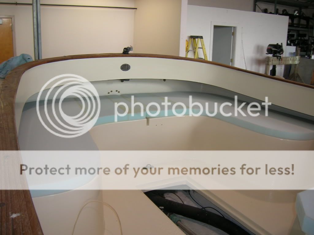

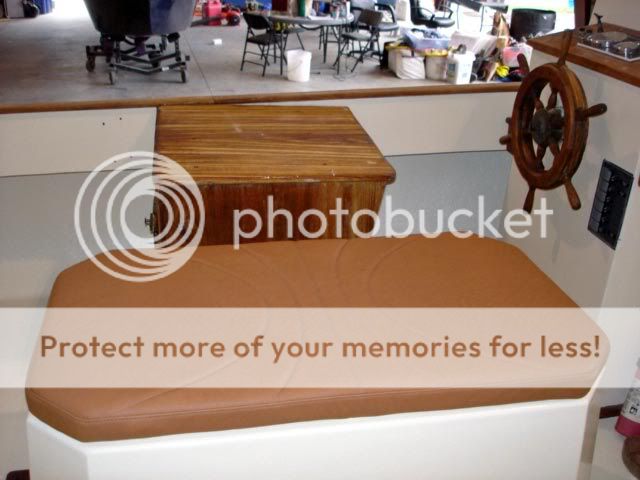

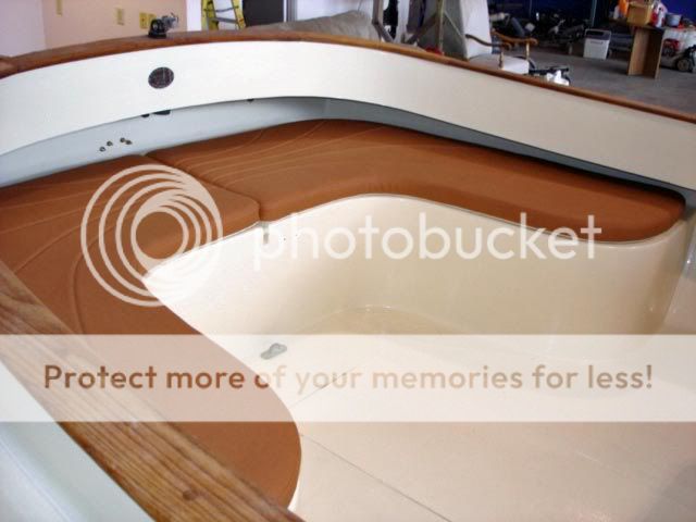

Before
After
« Last Edit: October 21, 2010, 01:31:45 AM by Cardinal Joe »

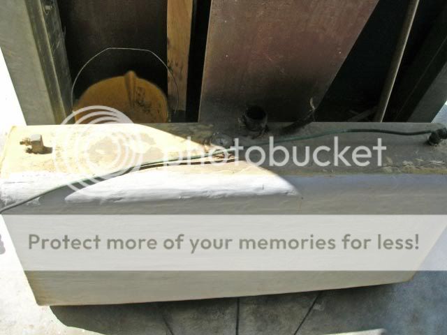

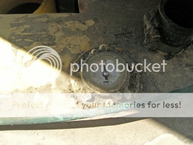

Had the 18 gal. steel fuel tank pressure tested - " Passed " , no leaks , so I remove it for a complete over haul . It has a fuel gauge on top of the tank , but impossible to see , since it is under the gunnel .
« Last Edit: October 04, 2010, 12:55:39 AM by Cardinal Joe »

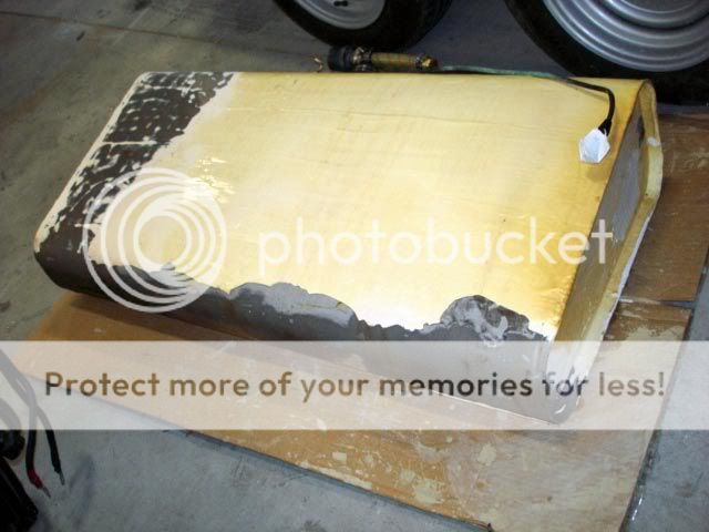

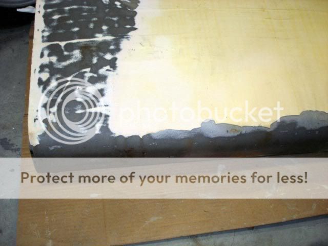

Used the Farrow paint removal system on the orginal 18 gal. fuel tank to remove the epoxy paint coating and found a large rubber tape that was applied to the tank at the factory , i guess to act as a rubber padding between the deck & the steel tank ?  When i removed the rubber tape , I discovered 3 small pin size holes . I shipped out the tank to be over hauled & repaired !

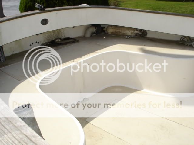

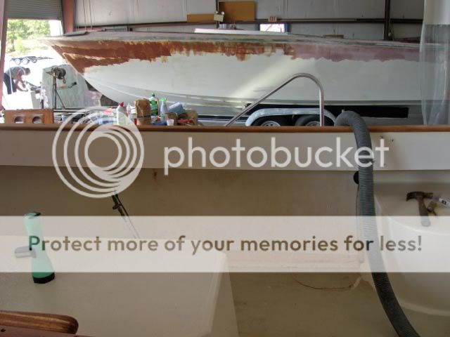

Replacing the old blower unit with a continous heavy duty JABSCO Blower unit - it is used to draw cooler outside air into the diesel engine cover box !
old unit - not connected
one of the holes is for the Blower & the other is a air intake vent for the engine compartment...
« Last Edit: October 30, 2010, 11:28:28 PM by Cardinal Joe »
