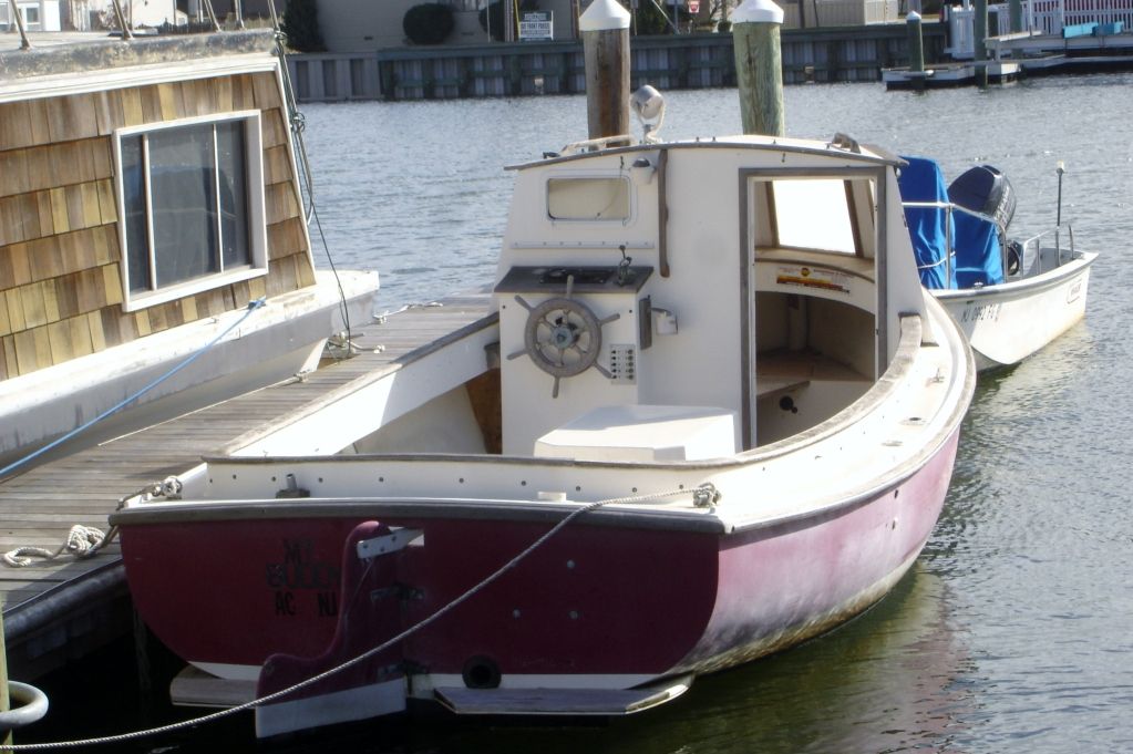

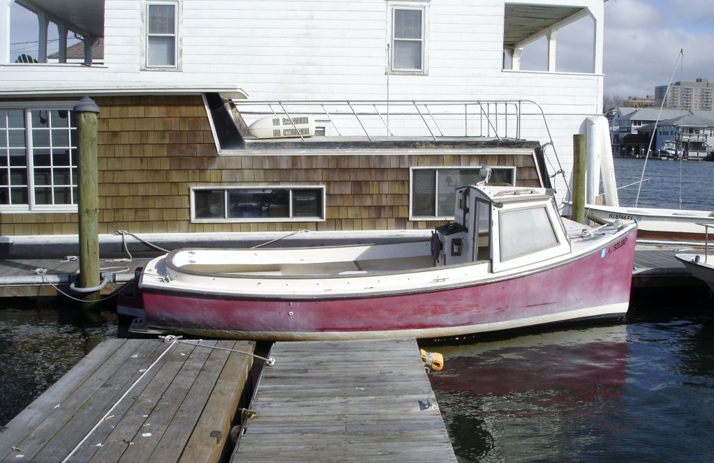

Or this?[img]http://www.flickr.com/photos/46762055@N04/8235151466/in/photostream//img]
The boat when I got it in 2008

WOW  - Kevin just saw all 37 pictures of before and after your Herreshoff Hull Restoration Project !!!!!!
Nice work on the restore of the hull and SORRY > for " Sandy " ......   :(

Thanks for the info Joe! Now that the top is off I can flip it upside down, form and build up the seat back around the front of the cabin and get to the inner liner with ease. I'll have to lay engine stringers, fill in the well, build up the transom like I've seen in the photos of  the Bay Fisherman and go the diesel route. Thanks for all the detailed pics you've posted and if I find any others, I'll post them here as well.

Lola's bow

Stern - Lola
