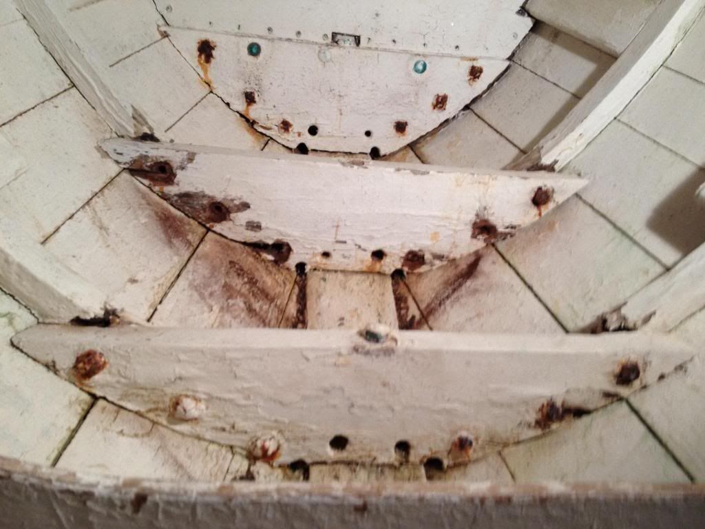

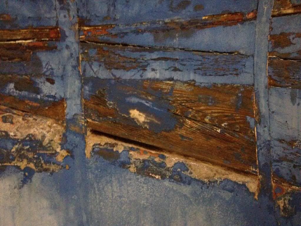

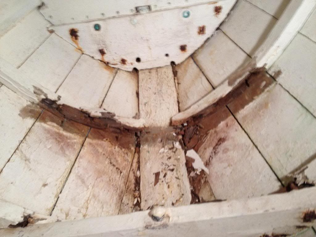

Lady Luck has been out of the water for over two years so there is a lot of of shrinkage in the keelson and deadwood as you can see in the following series of photos. I have scraped and removed some of the caulking and filler to check for rot. So far no rot!
The forward seven frames are rotted where the original iron bolts are attached to the floor timbers. I am planning a temporary fix to these frames by scarfing partial new white oak frames in place of the lower half of these frames. Three of the floor timbers also need to be replaced. Below you can see the third timber removed which I will use as a template to make its replacement. You can also see the rot in the lower half of the frames along with all the rusted out iron bolts. Once this is done I will replace the iron floor bolts with silicon bronze fasteners and bolt though the scarfed joints and planks. This repair should last at least 5 or 6 years until a more permanent restoration is undertaken.

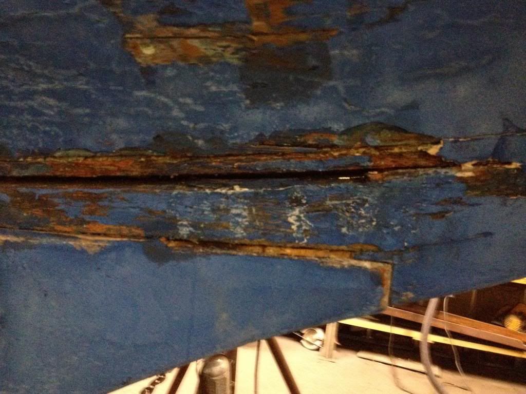

The stripping of the hull has commenced. It is coming of quite nicely with a heat gun a scraper. A surprise find; a filled in cove stripe and arrow head. I will definitely bring this back!
The White Oak shear strake was painted. What I have uncovered so far looks OK. I am hoping to clean it up so I can varnish it.
Close up of the Arrow Head. Maybe there is another term for it?
