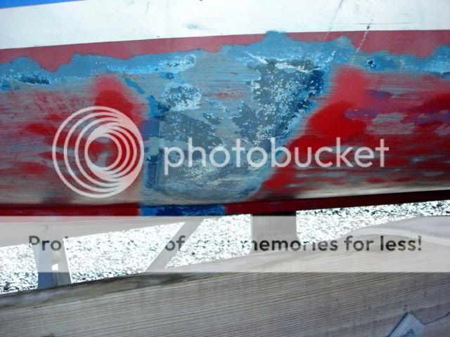

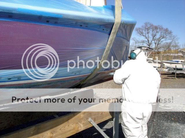

The Farrow SystemŽ combines the fundamental elements of nature - water, heat, minerals, and air - and forges them into a powerful cleaning system. Patented worldwide, The Farrow SystemŽ can clean surfaces impossible to clean with other systems! "A natural combination"
The Farrow SystemŽ adds heat to a low pressure mixture of water and Farrow Green CleanŽ, a chemical-free, naturally occurring mineral. Adding heat adds energy, creating free flow in the system and allowing air pressures can be low and still clean efficiently. This heat also causes the Farrow Green CleanŽ crystals to align before leaving the turbo nozzle. This creates a controlled, highly efficient cleaning stream that resembles a stream of darts.
This safe, low pressure vapor-like stream is directed against the surface to be cleaned. Upon contact with the surface, each Farrow Green CleanŽ particle bursts into multiple cleaning "missiles" that lift the coating from the surface. Each particle packs many punches, reducing cleaning time and media consumption significantly. The process is dust-free and leaves only a moist residue which is easily swept up and removed. "Cleaning method comparison"
Farrow Green CleanŽ is available in several grit sizes specially developed for a range of cleaning applications. It can take off just one layer at a time and it can also create controlled profiles specific to your application.

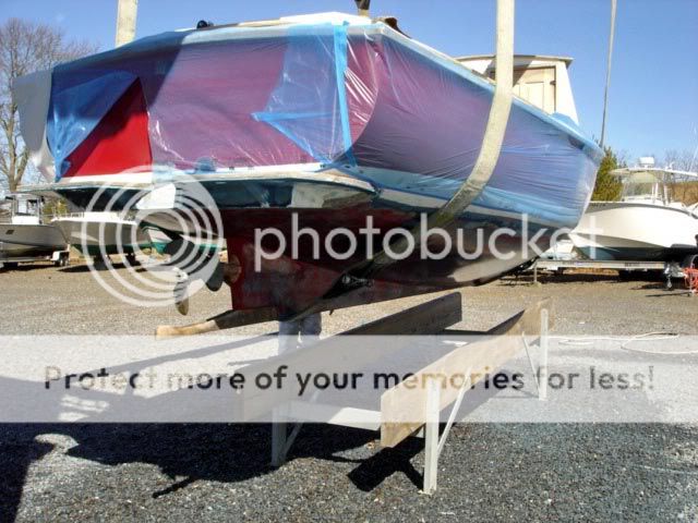

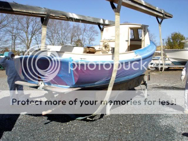

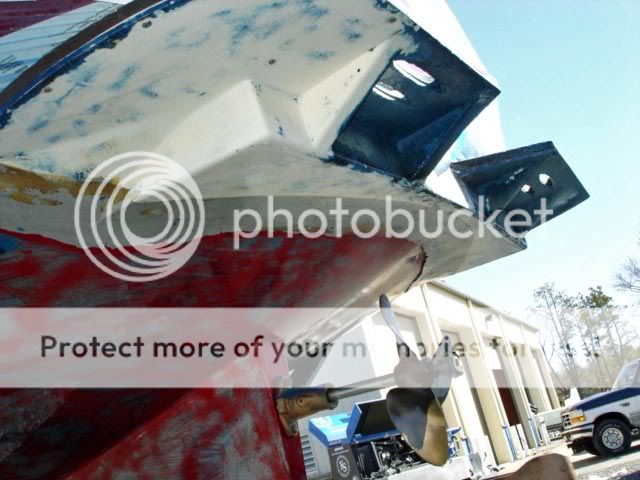

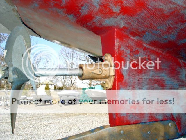

Adding a paint stand under the Pilot & Farrowing where the lift straps were holding up the Pilot ...
« Last Edit: October 15, 2011, 10:00:08 PM by Cardinal Joe »

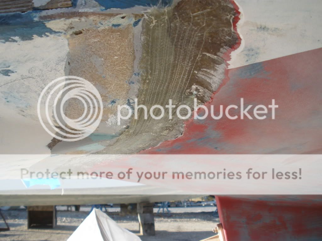

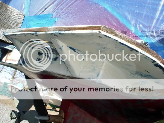

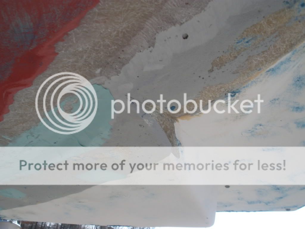

Done for day , tomorrow is another day !

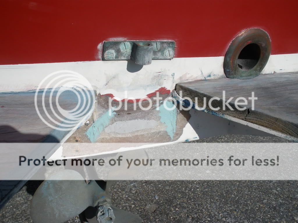

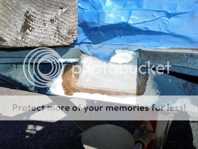

Found repair spot on the Swim platform ?....still need to fix the factory add-on swim platform Putty issues & start Barrior Coating the bottom etc.etc.....

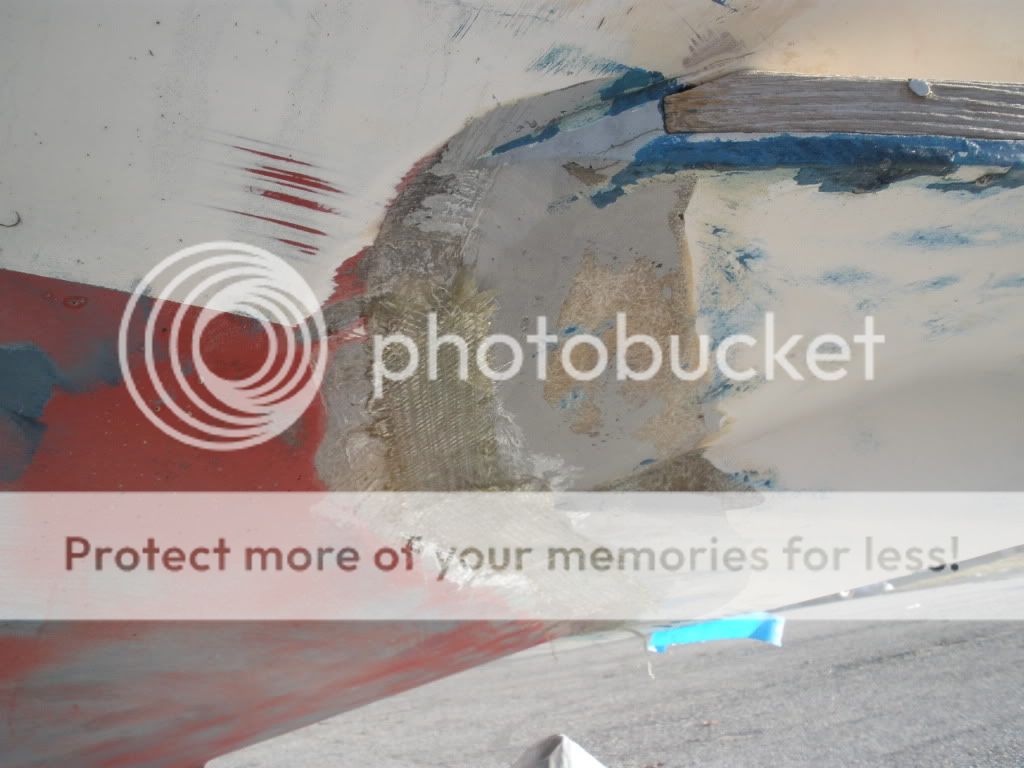

Here's some pictures of the fiberglass work done today on the swim platform. All 1708 glass and vinylester resin....
« Last Edit: October 15, 2011, 10:04:12 PM by Cardinal Joe »
